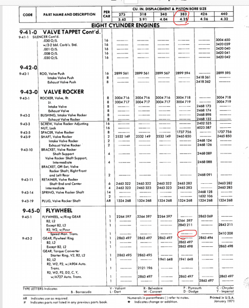

Flywheel has cracks, so needs replacement.
I measured it, and overall, not including teeth, it is 14-3/8"-Approx., wide/diameter.
I do have a parts list, (Attached and my car underlined), original Mopar I think, but doesn't give part number for my model, and looking at a few online distributer's, I only see 11" listed, etc.
Sorry and excuse my lack of knowledge in this area...
Any suggestions are appreciated!

You would use the 2843211. They make the parts book hard to understand. the 2264597 is for 10 1/2 inch clutch. The 2843211 is for 11 inch clutch.

That car will come with a 11 inch flywheel with a 143 tooth ring gear.
