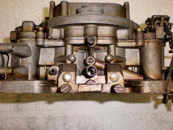

Here is another curveball in the carb situation....Received this pic from a different carb expert....He stated it is a difficult question to answer and he has seen early dated carbs in 3 ways in relation to the air/fuel etc....Here is a pic showing an early date.....H8 date

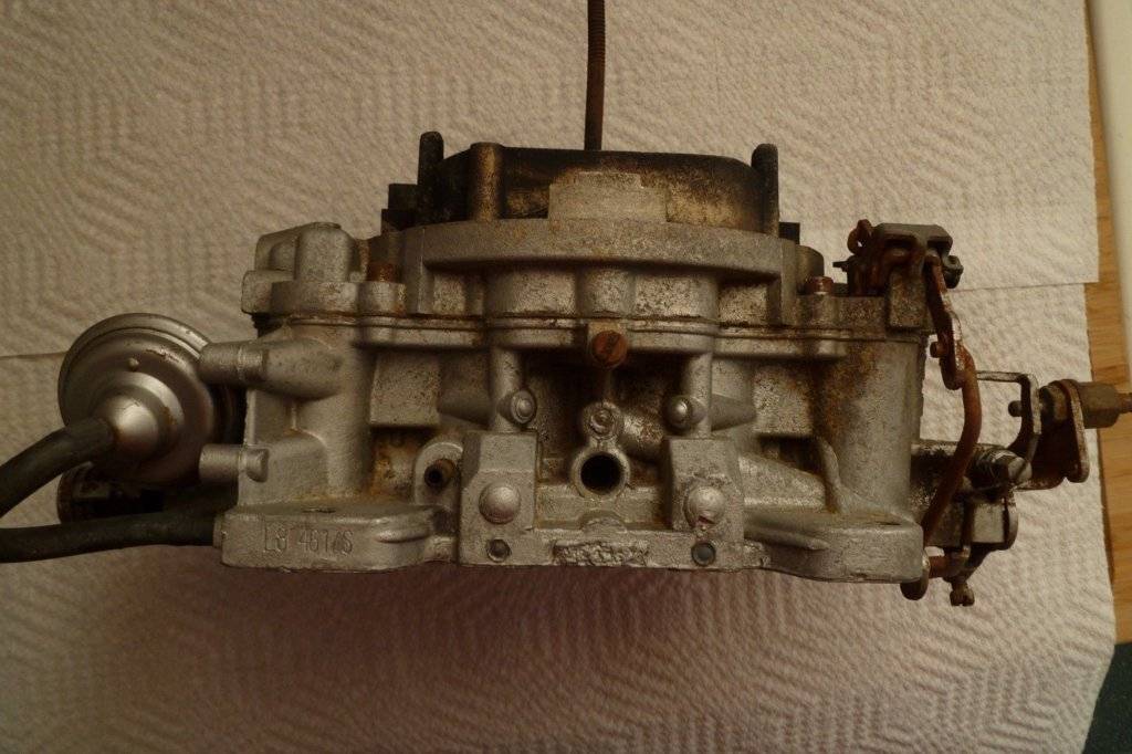

Here is the one from your eBay ad below...L8 date
