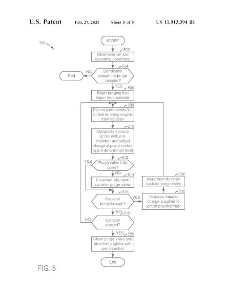

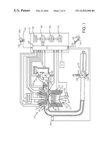

Engineers at Ford have filed a patent for a pre-combustion system that could dramatically reduce emissions and, as a result, earn a reprieve for gas-powered cars in an era of on-going electrification.
You might want to grab a coffee at this point as it’s going to get pretty technical. The idea is to take the gases captured by a positive crankcase ventilation system, or other evaporative emissions system, and cycle them into a pre-combustion chamber, instead of storing them in a carbon-filled canister, and periodically purging back into the intake, as is convention.
In traditional PCV systems the rate at which emissions are generated can sometimes exceed the purge rate and, when this happens, the gases are vented to the atmosphere, which rather defeats the object of the exercise. The Ford system makes much better use of any unburnt fuel coming through by channeling the vapors into a pre-chamber with an igniter.
“In particular, the approach may reduce an amount of time it takes to purge a carbon filled canister of fuel vapors,” reads the filing with the United States Patent and Trademark Office, first reported on by CarBuzz. “Additionally, the approach may improve combustion stability during purging of fuel vapors. Further, the approach may reduce evaporative emissions by increasing fuel vapor flow during conditions of hydrocarbon breakthrough of the carbon filled canister.”

A lot of weird/wrong stuff in the article
dramatically?
You might want to grab a coffee at this point as it’s going to get pretty technical. The idea is to take the gases captured by a positive crankcase ventilation system, or other evaporative emissions system, and cycle them into a pre-combustion chamber, instead of storing them in a carbon-filled canister, and periodically purging back into the intake, as is convention.PCV gases were never stored in a carbon filled canister.
In traditional PCV systems the rate at which emissions are generated can sometimes exceed the purge rate and, when this happens, the gases are vented to the atmosphere, which rather defeats the object of the exercise. if the crank case gases exceed the pcv draw, they go directly back into the induction . Not atmosphere.The Ford system makes much better use of any unburnt fuel coming through by channeling the vapors into a pre-chamber with an igniter.Better use? Unburnt fuel?
“In particular, the approach may reduce an amount of time it takes to purge a carbon filled canister of fuel vapors,” how long does it take to purge the canister. Not long.reads the filing with the United States Patent and Trademark Office, first reported on by CarBuzz. “Additionally, the approach may improve combustion stability during purging of fuel vapors.May? By introducing burnt inert gases? Further, the approach may reduce evaporative emissions by increasing fuel vapor flow during conditions of hydrocarbon breakthrough of the carbon filled canister.”Again, there is no evaporative emissions , it's a sealed system. Remember when you leave off your gas cap, the computer knows the system became open.
View attachment 1620140Ford / United States Patent and Trademark OfficeView attachment 1620141
Overall the system could lead to a more efficient fuel burn, no potentially increasing power no as well as reducing emissions  no. As an added benefit the buildup of carbon deposits on valves from unburnt fuel would also be reduced, improving engine longevity.This part might actually be a thing, but passing burnt stuff past the valves it sounds unlikely.
Obviously it’s early days and the system could prove too complex and expensive to manufacture,They make far more complex and expensive stuff than that. especially when the Blue Oval is investing heavily in electrification. However, it’s still good to see that Ford hasn’t given up on the power of combustion just yet.
