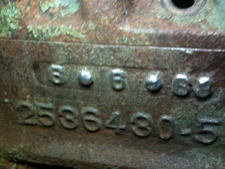

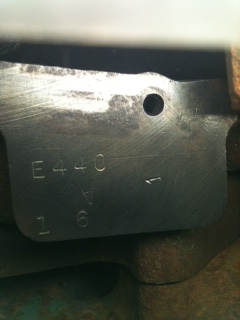

Can anybody tell me what I have in this 1968 440? Here are some pics.

LMAO Honestly your the first one to reply to my new post here. Inside this 440 has a huge crank, all the caps, no pistons and connecting rods. I posted pics of the ID stamp and manufactured date of this block. which is June 6 1968. Would this engine would have found it's way into a same year car because of the month and day of it's manufacturing? Or was it used in a 1969 model year car?
E440 would be 69. The stamp pad denotes the year of car it was installed in.
