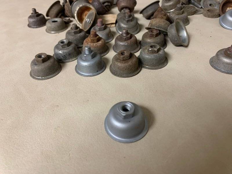

Found a source for the large rear 1967 GTX hood scoop bell nuts.

The rear nuts are 1/4-20, kit comes with no studs. The small nuts are pretty hard to start, but they go, wound up starting/chasing them off the scoop first, didn't like pushing on the scoop too hard.
I drilled out my rear scoop bosses to accept a cut down Ford Mustang scoop stud, then screwed and epoxied them in. I like that the mustang stud has the flat circle seperating the theads, came out pretty good. I dont think the kits from Mega or Classic come with the large rear nuts, plus they are on backorder. You can look for 10/24 hanger bolts if you are missing the small studs in the mean time.
Looks like a nice set. Considering I spent $25 on 1 of the rear bell nuts in the past. Where did you locate the studs? The studs are a larger diameter on the scoop side? Same thread pitch & diameter on the nut side?
Yes large diameter scoop side coarse thread, nut side is 1/4-20.I cut the coarse thread side in half to fit. Ebay item Hood Scoop Studs Nuts Mounting Hardware For 1979-1982 Ford Mustang | eBay I had to drill out the rear scoop bosses on the GTX scoop. They are Mustang scoop studs, my original studs were long gone. I used one size larger drill than the exisisting small hole each time until I could screw the new stud in. I marked the drill bit depth as well, you sure don't want to drill through the scoop....

Check out a header panel for something like a Cordoba if you can find one. They used something that looks similar to that stud. Anything that used those type headers and taillight extensions used them.
