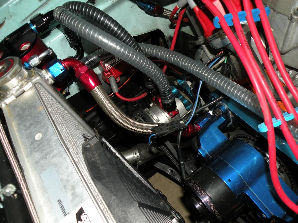

keep them. they work great. evac system. i use to use them ill i went to my vacuum pump systems.
