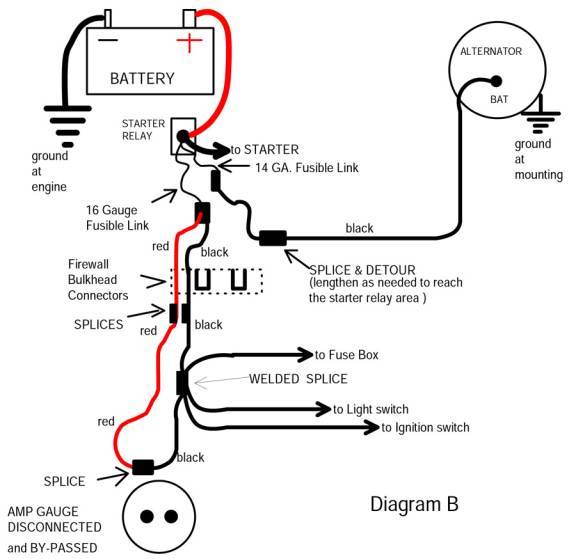

Found this writeup on how to convert your Amp gauge to a Volt meter.

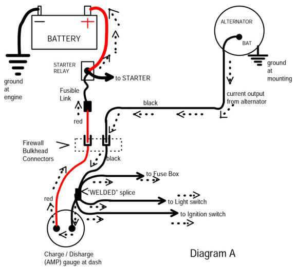

Why can't you leave the stock wiring and amp.meter. Connected and just add a 10ga wire from the alt stud to the starter relay.
The alt will then still charge would it not ?

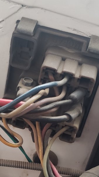

If the ammeter gasket is in good shape the easiest course of action would be eliminate the black and red bulkhead connectors and run solid wire or bolted connections. Loose fitting and corroded Packard connectors at the bulkhead are the issue.
I did the MAD bypass and have had zero issues. Also with the volt meter conversion. Both on my GTX. My Belvedere is stock, but the factory bulkhead connector is a bolt.
Lmk @Daniel Foster why you disagree? I am always interested in improvements.
Though know that this system has worked flawlessly for over 6 years now.

Though everything can be improved, I noticed that at idle when my electric fan starts then my rpm lowers.
