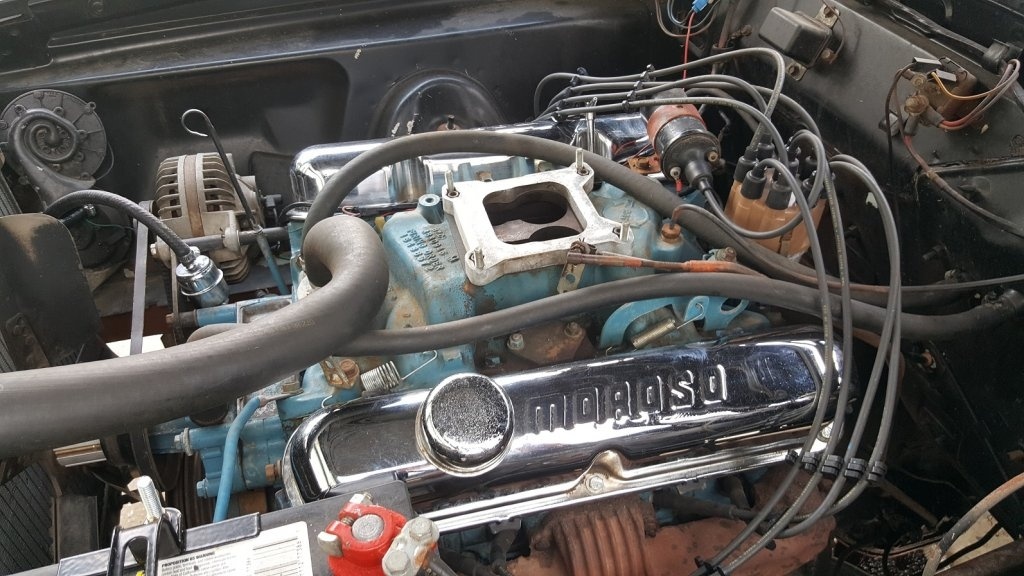

OK, I have a clean and decent stock 3604bbl in my 62 Belvedere (3.55 8.75 SG, 727 auto, stall unknown). I'd like to freshen it up a bit and I have a few things in the garage that will fit on this motor.
#1 Lunati #60403, Duration (Int/Exh), 268/276, Duration @ .050 (Int/Exh): 226/234, Lift (Int/Exh): .494/.513
#2 Power Plus Crosswinds dual plane intake (Eddie Air Gap knock off, a Christmas gift)
#3 Holley 4150
I think that I might need some stronger valve springs with this camshaft, maybe even upgrade to roller lifters/rockers.................and I would replace the stock manifolds eventually.....
any input from you on this appreciated.
Just out of curiosity, what kind of compression and heads are you running? Because that cam might be a little too much for 8.5-1 Compression and 1.88 valves!

A crap shoot, I have no idea what the engine is other than a 360. I suppose these is a casting # on the heads under the vc's? Terrible to have free cam and can't use it!

If I had to place a bet, I would say that those heads are 587 castings with the 72cc chambers.
If you have a little bit of coinage to spend, my suggestion is to get some Edelbrock RPM Heads. They have 63cc chambers and without changing anything on the bottom end you'll be up over 9.0-1. And because they flow much better than any factory iron head that cam will be a little happier since it has some extra lift, presumably for some higher end revving!:thumbsup:
Yeah.....coinage. LOL thanks for the info. Guess I will just put that camshaft back on the garage shelf.
I have the same cam in a RB 413 and I like it, but I have 11:1 compression... They close the intake valve quite early as it has quite a few degrees of "ground in" intake advance, so doesn't kill off your dynamic compression as badly as other cams of similar specs. You would definitely need better than stock valve springs. You can't put roller lifters on it, you can only put roller lifters on cams designed for such, so it's flat tappet hydraulic lifters for this cam only. Stock rockers should be OK as long as they are in good condition and you don't go too heavy on springs.
If your 360 is a stock bottom end with 8.5:1, this cam would reduce your low down torque significantly. Of course it will improve the breathing in mid to high end, but your stock heads and exhaust manifolds will severely limit the gains you should achieve. So really, the cam is not an ideal choice for your engine.
