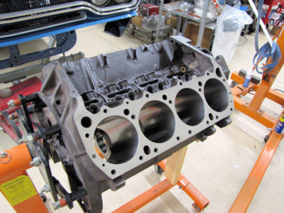

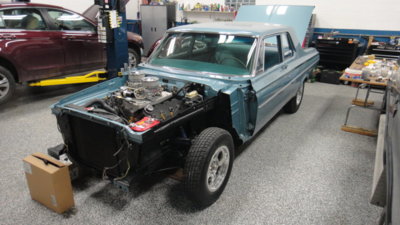

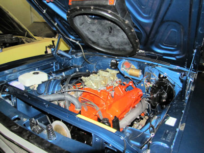

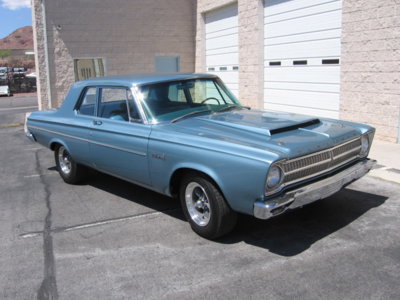

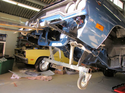

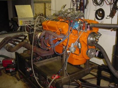

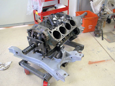

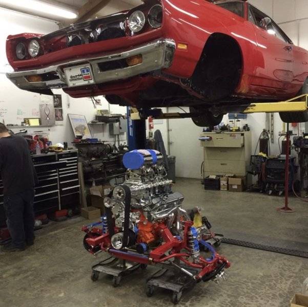

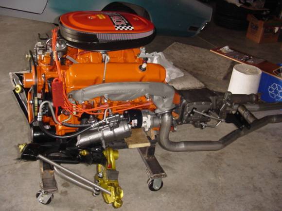

Build/install sequence for 70 440-6. 69 block machined. On dolly w/K member and 727. Full assembly on dolly/test stand for breakin. Lift front with tractor to remove front dolly and install engine. In car.

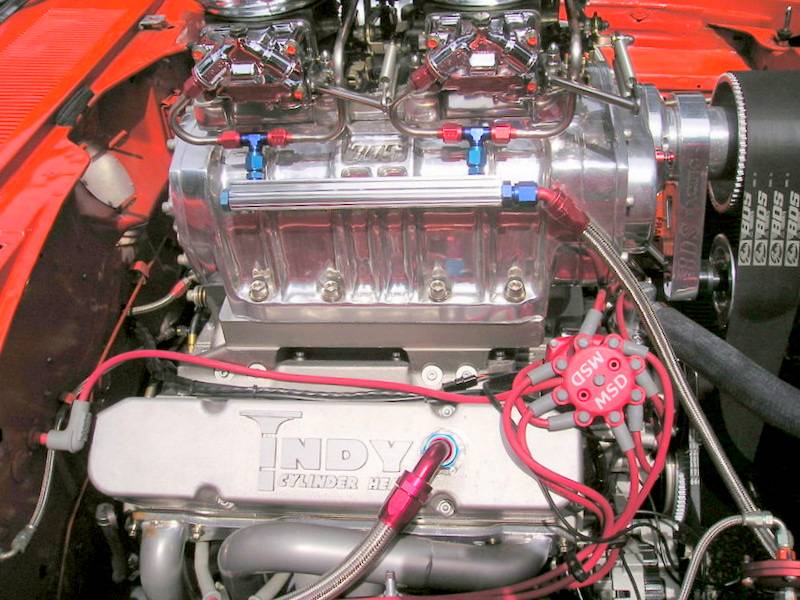

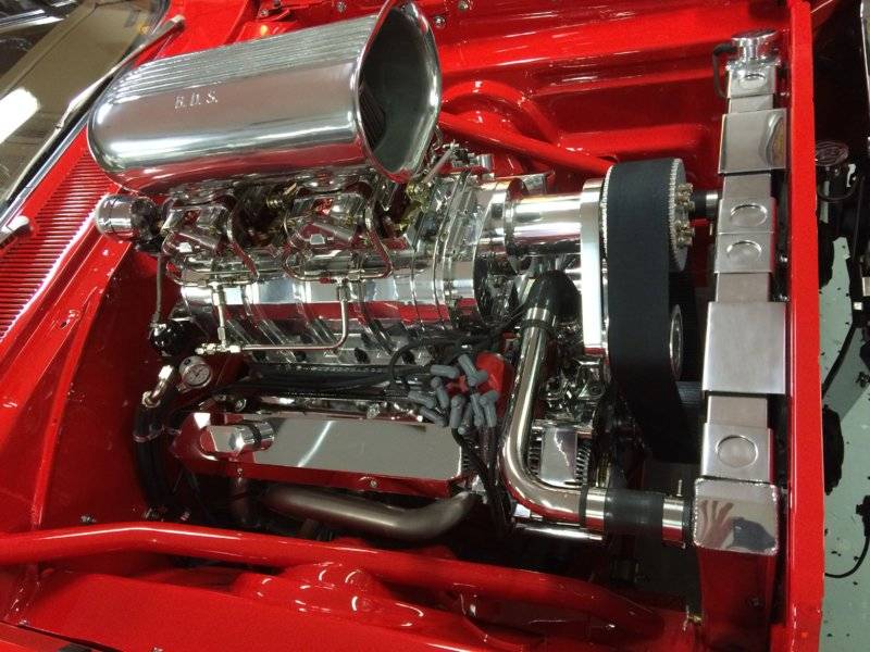

Mopar performance siameese bore 440 block 440-1 Indy top end full port polish bench flow, 8:5.1 Ross pistons, Childs & Albert super speedway rods, Mopar performance steel crank, Milodon dual line swinging pickup oiling system, Milodon gear drive,TTI 2 1/8" Step headers, MSD ignition 825 HP @6,200 698 TQ @ 4,200. Roller 727 no brake. FAB9 rear 4:88"s 14" x 32" Goodyears. for the street 31" x 18" Mickey Thompsons.
