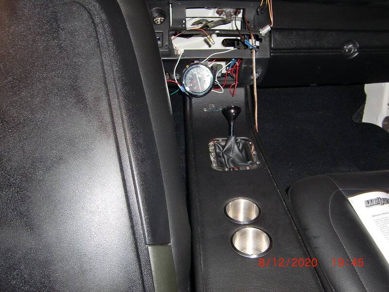

moved mine from column to console. Did custom design when I had interior done. Tach is just temporary location, used for tuning purposes.
