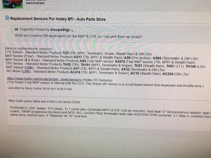

For those that may want to know —- don’t need to go through Holley for any sensor, have all the spares (including 02) and cost me around $100.
Wideband 02 - Bosch #17025

I don’t think someone can go wrong any way they choose, FAST / Atomic were some of the first systems, then FiTech for affordable units. Holley has the advantage of some of the best tuning software, from all the years of perfecting the Holley HP EFI ECU. Take a glance at my post above, all the sensors (for the Holley systems) are available at any auto parts store, same with FiTech or FAST.

Well, Holley stretched the truth a little bit. Wouldn’t make sense for them to tell you otherwise, they do sell all the sensors under the ‘Holley’ brand as well, just with a bit of markup. That sensor information posted above is from one of the main techs on the Holley forums. Some guys found an NGK 02 sensor that may work as well, it’s an actual standard OEM unit so would be a bit easier to track down. The one Holley uses is similar to what most of the aftermarket companies are using for wideband 02 sensors, it’s not necessarily an OEM sensor for general production cars.
