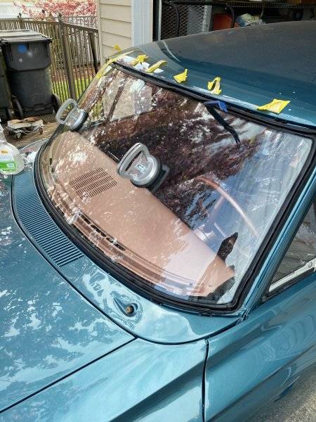

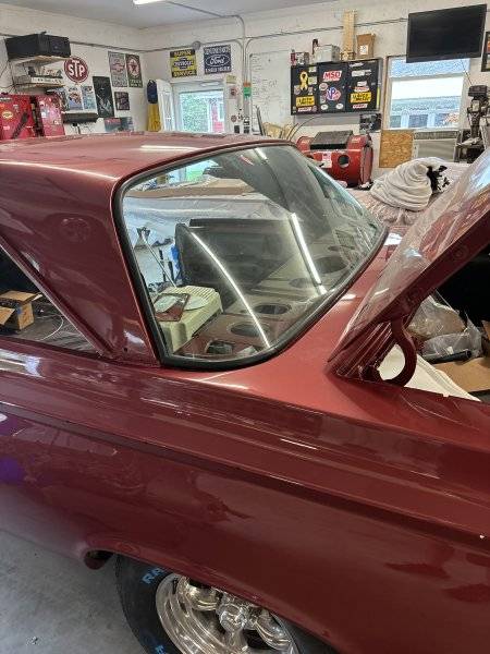

I am getting ready to install the front and rear glass on my 65 Coronet. I have done a lot of research and have the gaskets. My question for anyone that has done 65s is about the method. Are they the same (IE - rope type) or are they different (rope rear and front gasket first the fit in glass)? I have seen info for 64s and 66s but not 65s.
