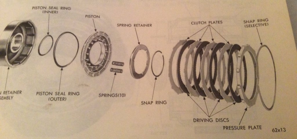

I am in process of rebuilding my 727
seems my front clutch pack has about 1.75 of clearance
FSM calls for 0.47 to 1.10
Is there any issue if I install 5 friction/steeles to bring me inside tolerance?
with 5 steels/friction i would reduce my tolerance by 1.30 and with a 0.60 ring it would set me to 0.55 tolerance
FSM calls or 0.48 to 1.10 clearance for 4 frictions not sure if that would change with 5

My service manual (1966) calls for .056 to.104 clearance. Snap rings come in .060-.062, .068-.070 and .076-.078.
I assume you have pressure plate that's last piece in?

You want .012"-.015" per clutch. One additional friction and steel will gain you roughly .165". You can add one steel between the thrust plate and snap ring to tighten up clearance. Thick steels (.090") are availible as are thin frictions. 4plate clutch will hold easy 700hp. Mine runs 5 thin frictions at .070". 200 runs @900hp, no issue at inspection, reused them.

to check tolerance i am pushing down on the pressure plate to see when my feeler gauge is no longer able to slide under the snap ring
is this incorrect?
As long as the inner surface where the stator support rings ride isn't worn the drum will be fine. Just slide the feeler gauge in, dont jam it. A little loose is better than too tight.

im able to get into tolerance with putting a steel right after after the thrust plate

Rear clutch now...okay. I'll just assume you've got the clutch pack stacked right. On the rear clutch, the wavy ring goes under the clutches, on top of the clutch/piston retainers.
Sorry, just trying to picture what you have. But, if you have a reference book to go by...
Checking that clearance should be done, with the parts dry stacked.
i was having issue with front clutch pack (the one without the wavy ring). the clutch pack with the wavy ring is ok
i was having problem with front clutch pack with excessive tolerance but dvw said to place a steel after the thrust plate which brings everything into tolerance
