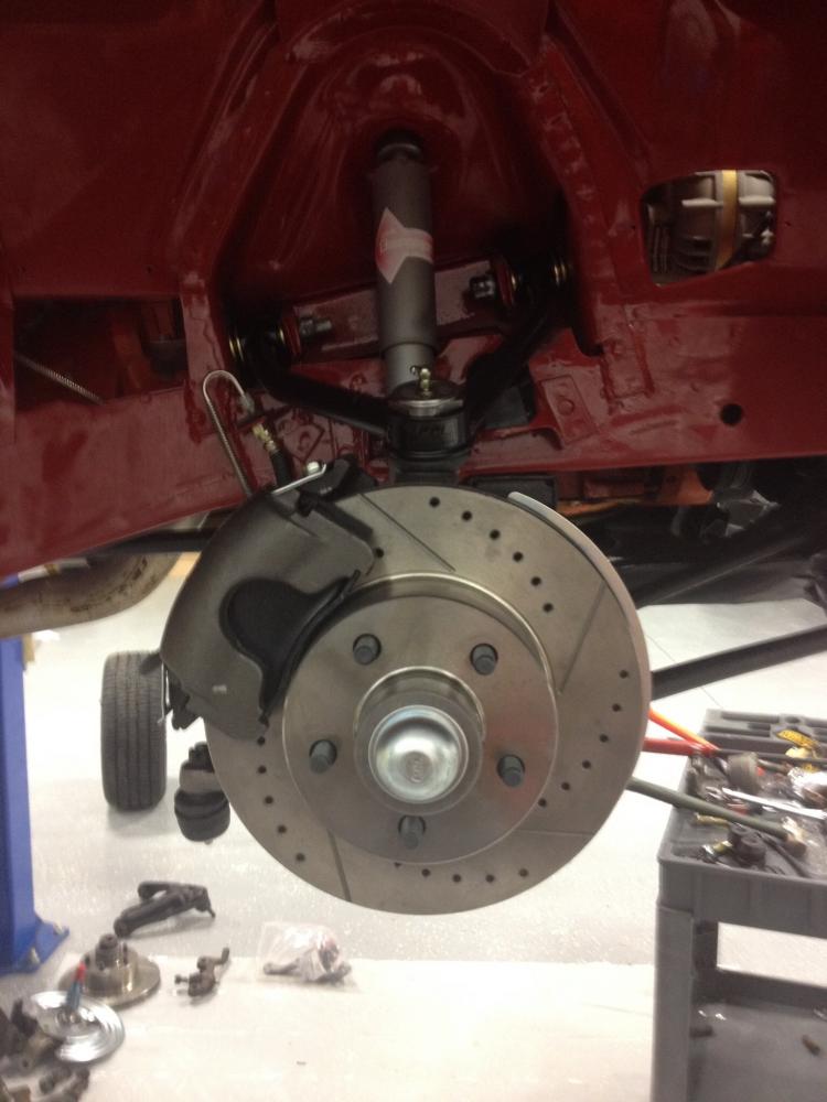

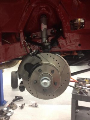

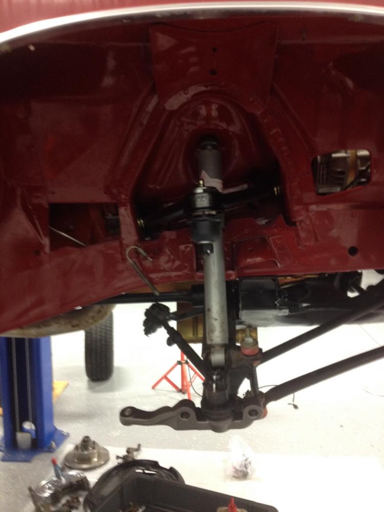

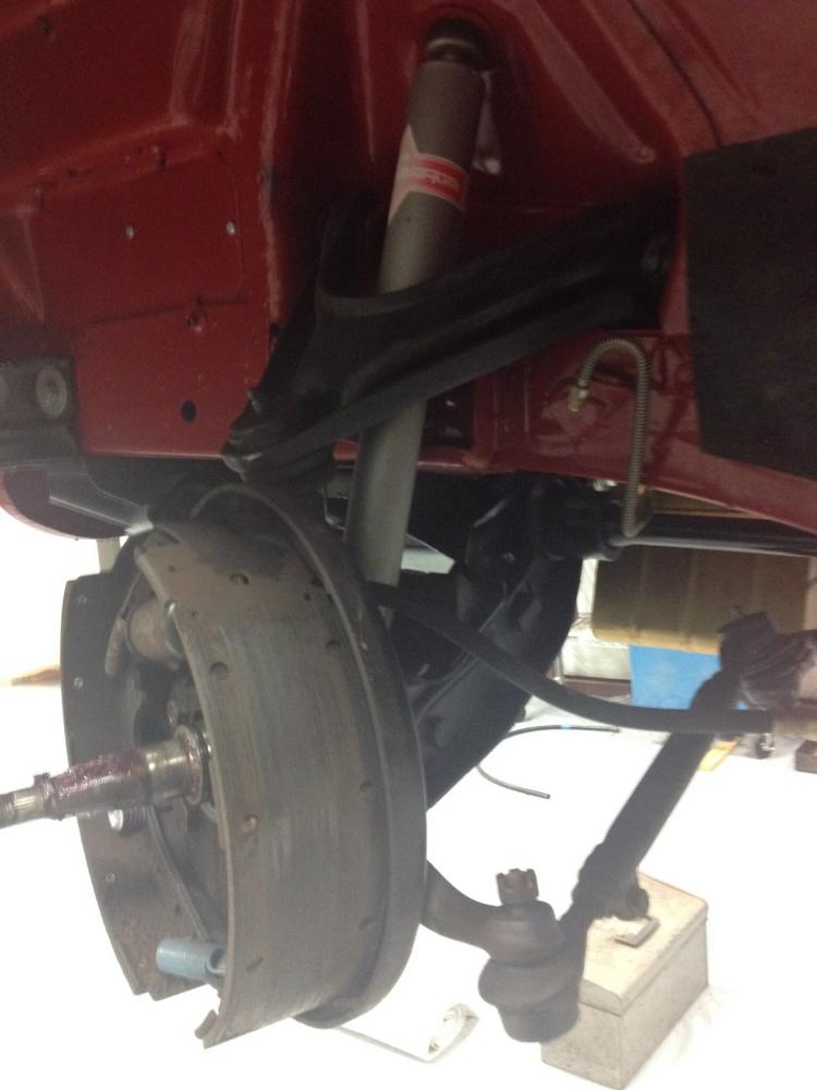

A few pics of the disc brake conversion from Ram Man on 68 GTX, hope it helps! Also added tubular upper A arm from Firm Feel which added 3 degrees of positive castor and urethane bushings. I am not a big fan of KYB shocks, but these are new so I will run them a while and evaluate while looking for better options.
