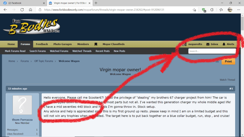

This one has literally been done to death here.
I suggest you do your own research therefore - the FBBO Search Box:
