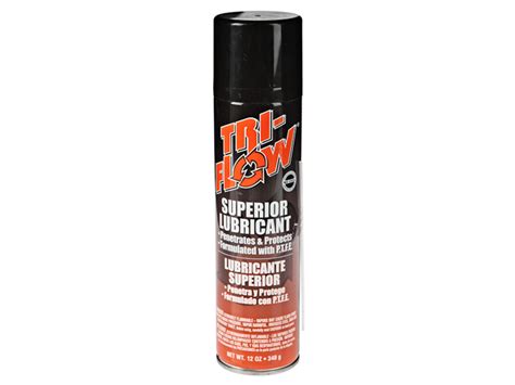

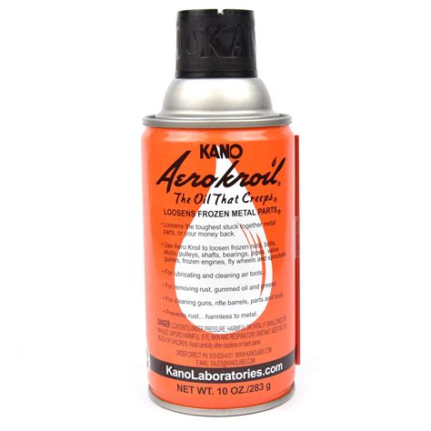

WD40 is not your friend. Use a quality lubricant. Don't use white lithium grease in a spray can. Generally you get what you pay for. Don't buy it at an auto parts store, way overpriced unless on sale.
Tri flow
Kroil

Kroil is my go to, they say acetone and trans fluid with a 50/50 mix works better but I haven’t tried it.
