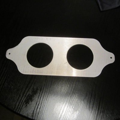

There was a member on here a while ago who made a bracket to mount 2 small speakers in place of the factory front speaker. I sent him the mounting bracket out of my 68 coronet parts car and he made me a bracket just for sending him my old bracket. He is also on the A-Body site
I believe he went by 75DartSport

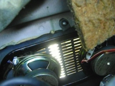

I used the factory mounting holes and some spare strapping to fit a pair of 3 1/2 two-ways under the dash grill. Pic gives you the idea.

I like the idea of using the factory spot in the dash. Anyone who is doing this have opinion on how it sounds ? What brand/type of speaker did you use ? As for 75dartsport, I think I worked with him for awhile. It was right after shoulder surgery and I tried to get him good pics, sent him some templates I made but never could get it right. If it's the same guy, he is meticulous and like all engineers, wants the finished product to be exact, as it should be. Maybe I'll try to get back in touch now that I can crawl back up inside for better pics. He was pretty helpful but we just couldn't get together on the thing.

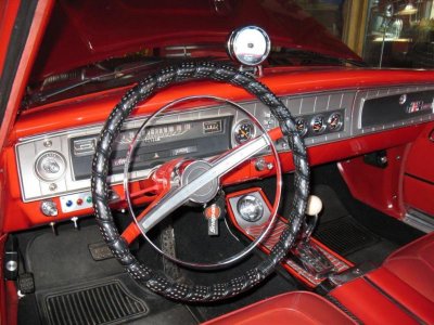

Thanks. I like the placement in the kick panels. What does hook and loop mean ? Is there enough room for the magnet on the drivers side ? I know there is a ton of room on the passenger but there doesn't appear to be much depth behind the driver's side. Can I as k a couple other questions. I still have some loose ends to finish up. What are the toggle switches for under headlamp switch ? What is mounted in the spot on the cluster that I think used to be a clock ? Is it still a clock ? Final question, where is your radio ?

No you won't have any room for speakers in the kick panels. I also went with the undercover 2 speakers under the front seats. In passed cars I go all out with the stereo, but this cheap setup sounds better than some other cars I have had with big dollars in it.
JVC head unit, under cover 2 speakers with a 500 watt fosgate amp and the Pioneer tune ups, I would guess I spent under $300 total.
