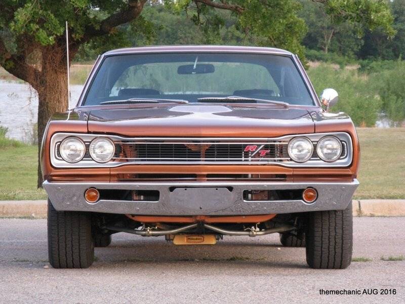

This is what it looks like now. Seems right. This is not my car though
Thanks! That’s what I was thinking too. Would the angle be too different at the ends? Look like there’s some spacers on the mid brackets
The one you posted is an aftermarket bar, so yes the brackets are not as close fitting as original. Original bars also have the bend in the middle. It’s to clear the lower radiator support brace.
Thanks a lot for the help. Mine is a bigger aftermarket one. No idea of the manufacturer. Silver one with no markings. Likely done 2002 or so.

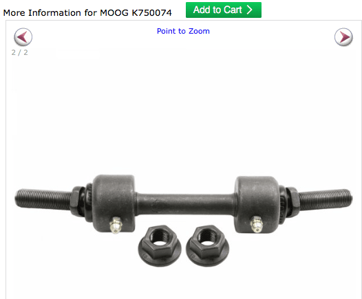

If you want one that everything lines up nicely on buy the Hotchkis.... Honestly it doesn't effect the way the bar works, it might cause the sway bar link bushing to fail prematurely but they are pretty cheap & I change them every five years as a maintenance item...
Want to eliminate binding & increase sway bar effectiveness? Replace the end links with these...
i got the same thing going on. looked at^^^ looks like the answer thanks 1 Wild rt, again
