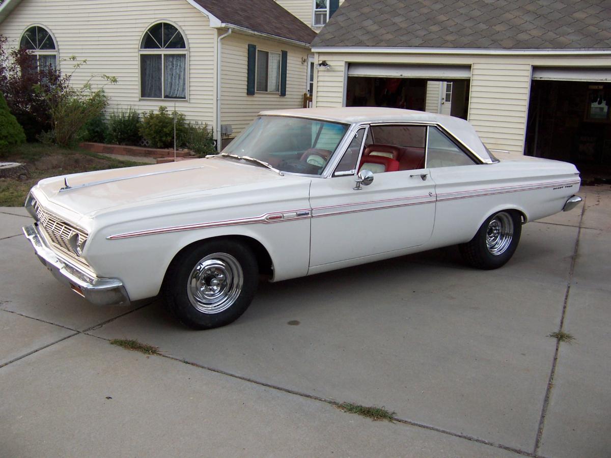

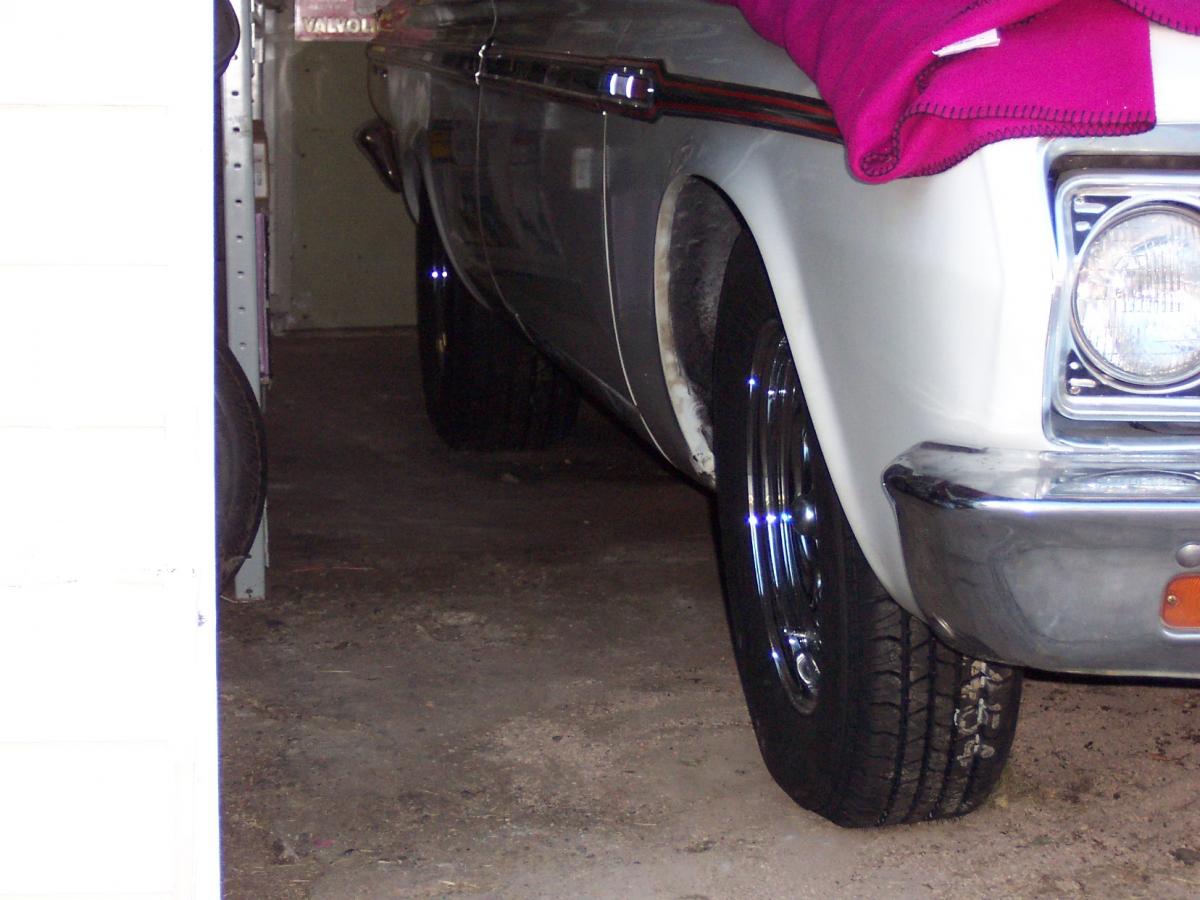

This is a set of 15X5" steelies with a 3" b.s.;I think TT's are the same in dimension. Tires are 205-75R15's
Thanks Al K. Are those 275/60-15's in back too? BFG or similar front and back. Ordering this week when I get back in town.
Those are 255-70R15's on the rear;29" tall. Cooper Trendsetters on the front,Cooper Cobra GT's on the rear. The rear wheels are 15X8 with 4-1/4 backspacing.
