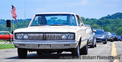

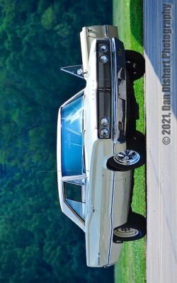

Nice looking coronet. Anymore pictures of it?

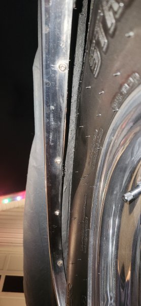

That one only rubs on the right, the most miniscule amount when I'm hammering around county road turns when my wife is in the car with me. (She's not big, only 110lbs, don't mean it that way). Keep in mind that's 57 year old bushings and springs too. The coronet with only 23 year old springs does not rub at all. With those wheels and tires.

MAN that looks close! I would never be able to drive that without worrying about damaging the metal.

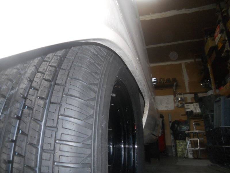

If you roll the inner wheel well lip in you can fit 275-60-15 on 15x8 4.5 backspace. They can fit well on some 66-67 B bodies and might be tight on others. My car's right rear wheel well is at least a 1/2 inch tighter then the left side. This is a old photo, I now have a narrowed Dana and 15x12 wheel and larger tires.
