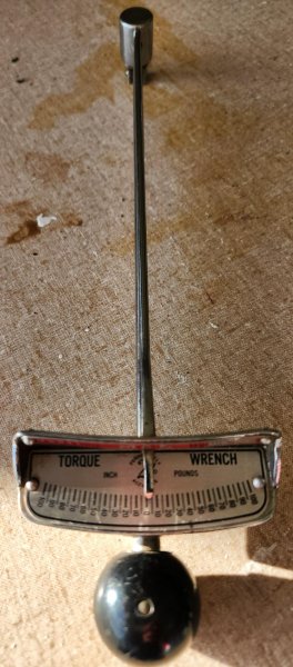

90 in. lb. with a old beam or dial wrench. 1 in 500 guys may have one.
One of these? Just used it...maybe 10-years ago now.
