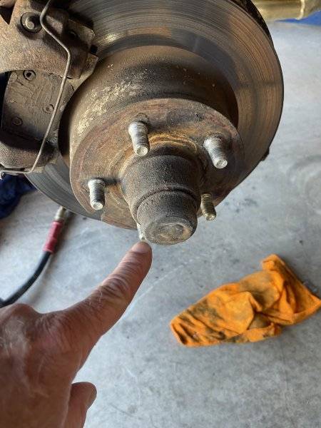

Anyone know what size or part will fit as replacement front disc hub dust caps? My other one is pretty beat up.

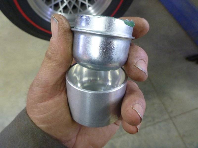

Dorman 13996. And they're tight! There's no harm in taking a ball peen hammer to the inside and knocking out those dents, you're probably going to do that much damage to the new ones!

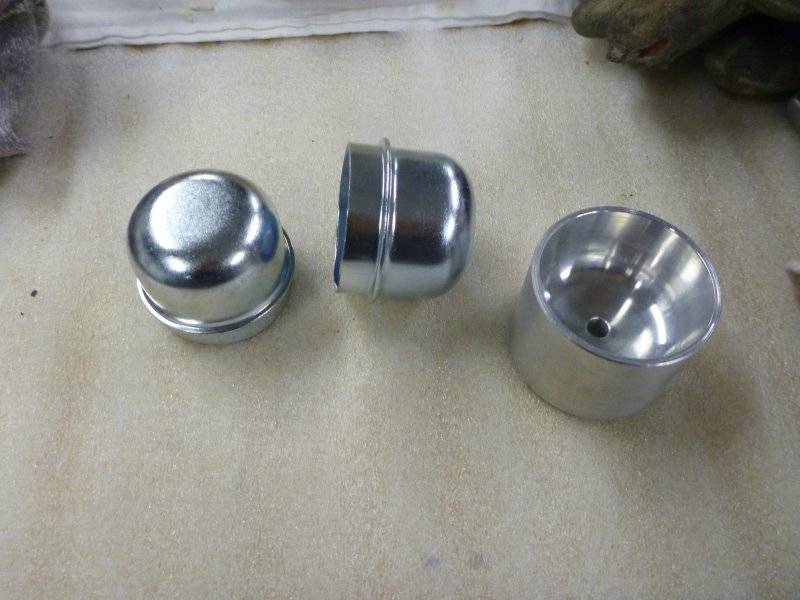

Straightening them is easy. clamp a ball peen hammer in a vice ball side up.. Lay the cap over the ball end. Then tap with a hammer from the outside of the cap. I've fixed hundreds in my days as a tech. I would never let a car leave with a smashed part. Some of the aftermarket ones fit. And some don't.
Doug
Thanks mate! This is most helpful as it will probably save me the grief of having to make multiple trips as some are too loose. If I went to either Autozone or Oreileys with a dimension they would just stare at me like they always do.

All you actually need is a pipe cut off to match the collar diameter.
Yeah well, where ya gonna find that at 11:30 at night ?!?!?
Me... many places. Shop cut offs beside the mill, crap pipe out in the hangar, the squashed trailer full of 4130 tube beside the hangar, etc... LOL I think 2" ABS drain pipe is the correct size...
