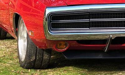

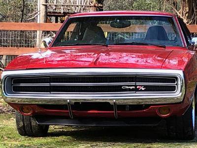

The OP has some NEGative camber. This is actually GOOD for cornering and stability as long as it isn't too much. I have 3/4 of a degree.
Is it more than mine?
