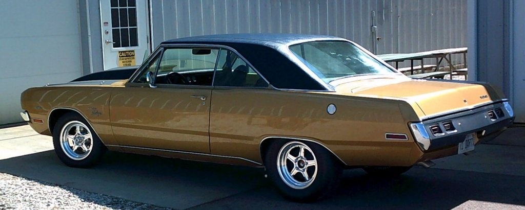

Thanks Cranky...I had to go thru all that rigamaro with my Dart. Wilwood discs, adjustable prop valve, particular bore MC, but don't have any problems with it. But the car only weighs 2920 lbs. With 580hp I still needed to stop it!!
