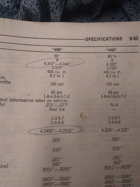

Engine specs,
400 bore dias don't match
Cam Bearing bores same as journals.
Yes, Like anything else mistakes have been made. I don't remember what year but a mistake was made on the small block rocker shaft torque.Yes I snapped a bolt off in the head.I knew it had to be wrong,felt wrong,snap.Yep.
Found many mistakes in the Mopar Performance 1997 catalog too.
