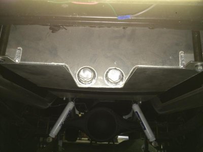

Have you seen the posts by 65roadracer about the fuel tank he had made? He'd wanted a baffled tank to get good fuel pick up on the road course and got one made at Rick's tanks and it goes in the stock location. You can find it on the streetlegaltv website also.

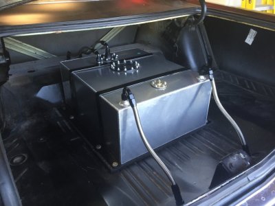

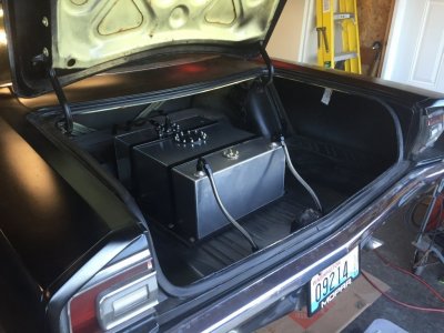

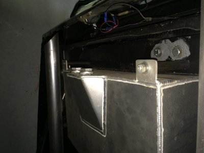

Here's a few pictures of my setup. It's a 20 gal. fuel cell.

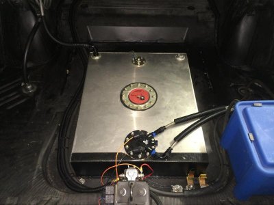

Here's how I did mine.....20 gal Aeromotive A1000 stealth fuel cell from Summit, I have about 2k into tank, fittings, line. regulator etc
very nice looking setup. I am hoping not to be in the 2k range. I still have about 15k to spend on a 10k finished car lol. Sure adds up quick.
I followed the advice of the forum and went stock tank. I bought all the parts for a grand total of 225 dollars. Another 250 for fuel pump and lines. Way less than the fuel cell I was looking at. And its 19 gallons.
