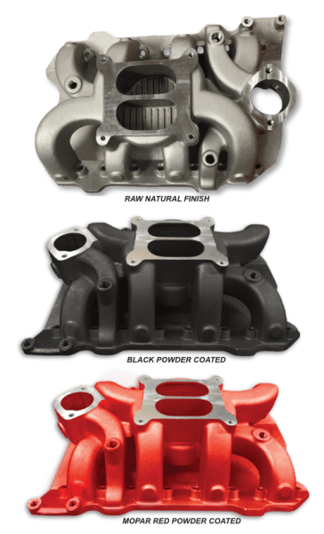

Try and find a new Dual plane from the Poly Guru, Gary Pavlovich and pals.

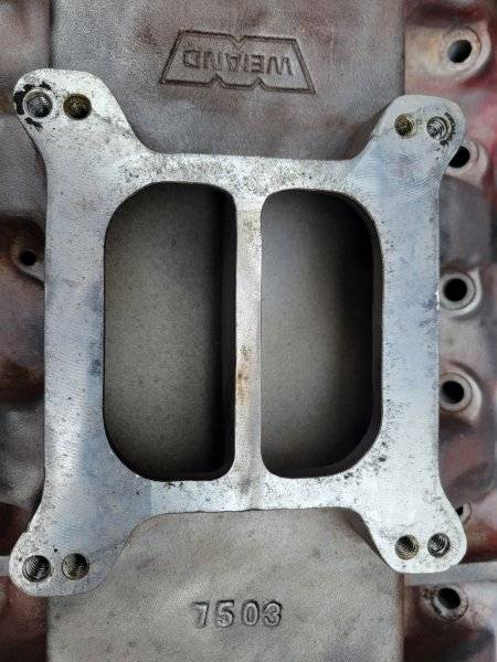

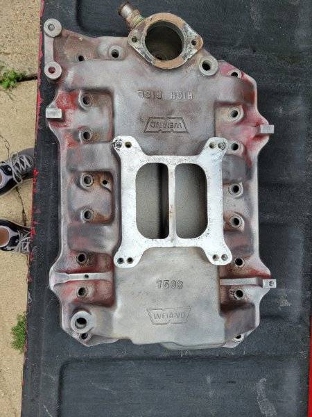

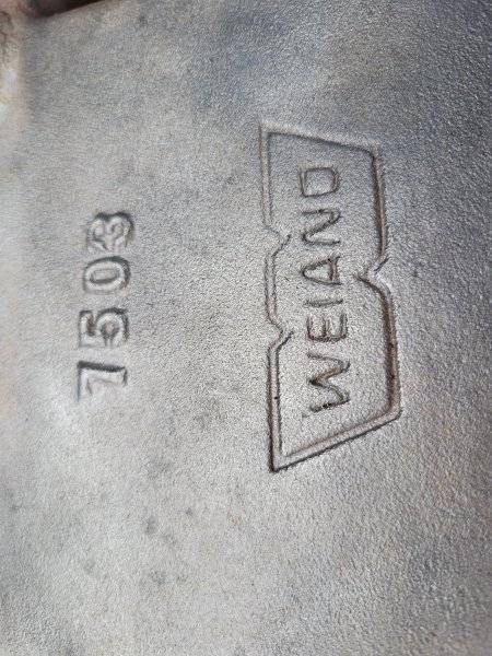

IMO.....The only "problem" with this type of manifold is the large plenum area directly under the carb and the way the intake port runners are configured. The origional manifold had 180° flow pattern and better distribution. The Weiand manifold has a huge open plenum which will cause a large mixture pressure drop and a resulting DECREASE in mixture velocities, especially at low RPMs and nominal throttle opening. Low mixture velocities will result in possible poor distribution patterns, especially with the runners st the ends of the plenum. This usually results in low torque output and possibly poor throttle response. It would be a poor candidate for a throttle body injector system for those reasons. Ideally, the faster the mixture velocities results in better distribution and smoother operation and throttle response. Just something to consider.....

Agreed but there isn't many poly manifolds out there. Choices are limited.
The new Poly intakes were sold out real quick!
