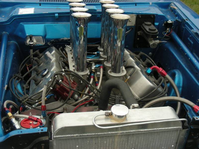

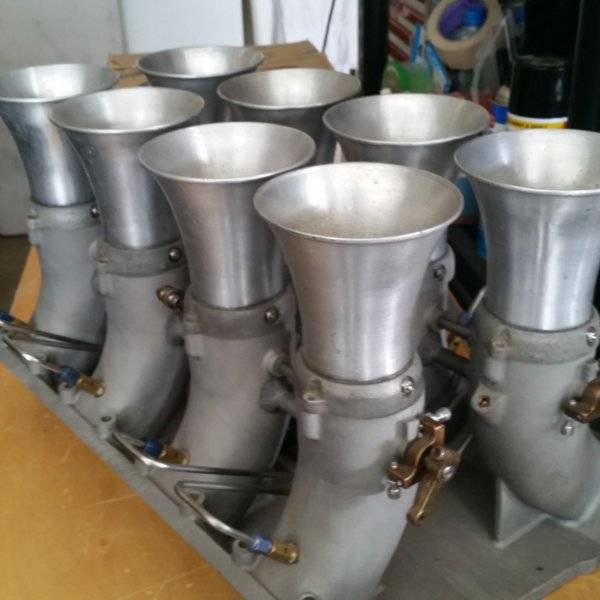

Then....I am considering setting up my car with the Fuel Injection Setup I just bought (pictured). I would run Alcohol and when allowed by the track I would certainly add a big shot of Nitromethane.
I ran Hilborns on my Funny Car back in the 60's, running a mix of Alcohol & Nitromethane for "Run What You Brung" Match Racing.
This setup I have is Enderle but the setup is in excellent condition but I need to buy a surge tank, pump, bracket & drive belts and fuel lines, etc. to install the system. I would have about $3500 in the entire setup when done.
Even though "short" tubes are adequate for my current setup (transbrake, leaving at 5000+RPM) I would still want the "long" tubes for the nostalgia look. Hemi Cars ran the long tubes back in the day because they didn't have transbrakes and were launching at around 2000rpm off the footbrake so the long tubes gave then more power down low.
My motor back in the 60's was a 426 Max Wedge and Hilborn only made the short tubes for that setup. (pictured)

i have a hilborn setup with nice tubes, new pg150 pump,fuel shutoff valve, pills,nozzles(gas and alky) and spud for 2000cdn if you're interested
I assume you're talking about going with an ol' style
mechanical fuel injection, cam or belt driven fuel pump
180a or better/maybe more
barrel valve specific, for alcohol (proper linkages etc.)
with an idle bypass & high speed bypasses
with a mechanical fuel shutoff
going to need to re-plumb most of it too
maybe a new tank/cell upfront
so it doesn't have to pull the full fuel against the g-forces
it works for you not against you
new hoses/soft lines to/for the nozzles,
from the barrel valve or distribution block
a lot easier than the hard lines to deal with changes
especially nozzle changes
will need a bunch of pills to lean or fatten it too
maybe shims or springs for the bypasses etc. etc. etc.

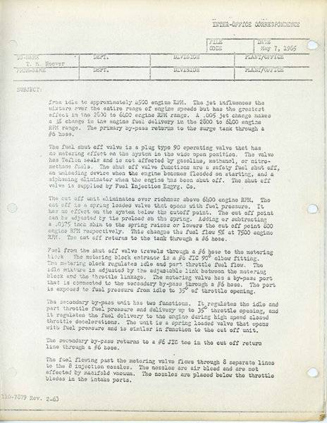

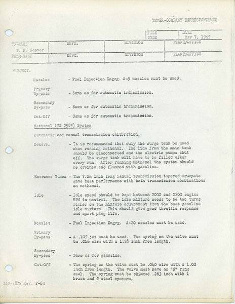

old 65 MoPar engineer bulletin for AFX Hilborn set ups
cool old stuff, kind of tough to see so faded
just thought you'd like it
right up your ol' alley, back in the day

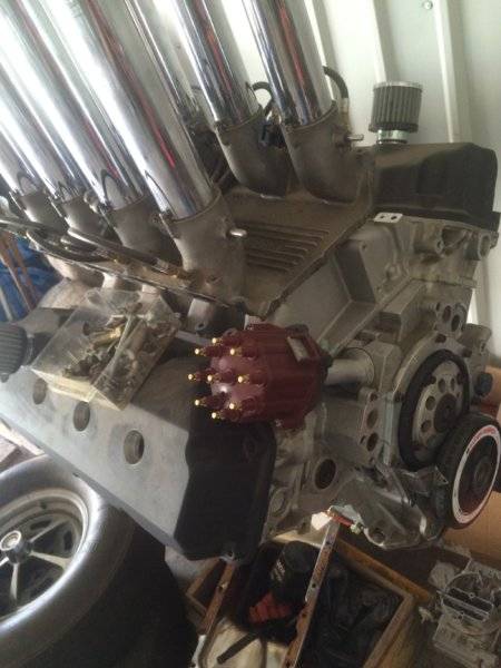

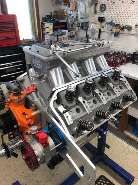

..had issues with the old motor so never got it running properly..new motor has raised intake ports so couldnt use this setup
What do you mean by "raised intake ports"...just curious, thanks, mike
...i have the millennium head now that has a raised port height and uses a 10 bolt GM style rather than the stock 16 bolt configuration :)
