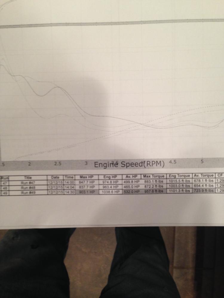

I think I finally got the injection sorted out. Here are My last three pulls on the dyno today.
I thought I had a video but I guess I didn't hit record.Sucks cause the car sounded so nasty.I am a bonehead.
Charging system held and the car made five pulls at 835 to 847 horse with 875+ torque .
The final pull was the best. 903HP and 957 Torque

Damn Joe! That is straight NASTY!!! Would have loved to see that video but really just happy to hear after all the trouble you've gone through that it's looking up!
Is that still around 15 psi? Those are crazy numbers especially for rwhp.. In a DRIVER! lol
Thanks Mike,yeah that is @15 psi. When the weather breaks and we get some clear roads I am going to try and video the car. Maybe this time I will hit record.LOL

LOL. I was use to driving the car with the carburetor set up.On the Dyno the carb did 840HP 839TQ once and the rest of the pulls were around 780 or less .When I drove the car
this summer it was always hot so I am guessing it was making around 750HP or less . With the injection and intercooler the car made consistent pulls at around 840HP and 870TQ with the best being 903.
I need to learn how to drive it again. I took the car out Monday night before the snow came through and got into it like I would before and well its a different car.The cold roads didn't help but I tried to run through the gears and I could't do it. When I got into boost and shifted into third the tires were just spinning and I couldn't keep the car straight. But I love all that power.It's a rush!
