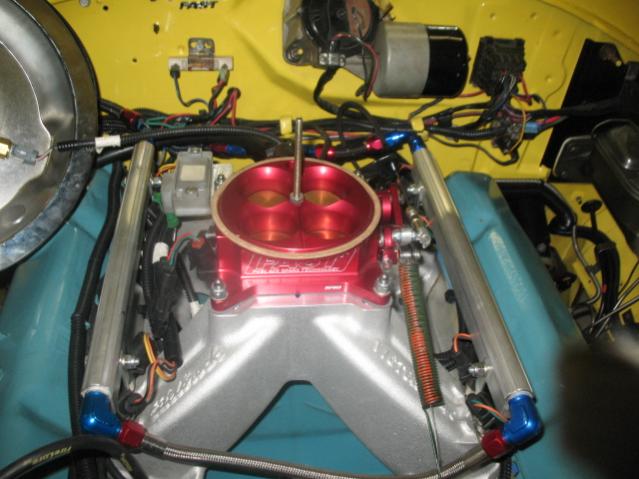

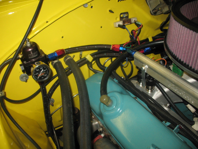

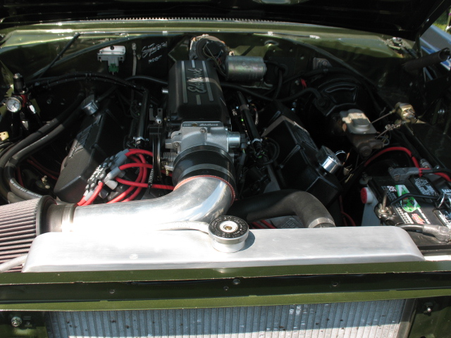

Installed Fast EZ multiport this summer. Competition Components offers a Fast EZ multiport kit
http://www.buyracingparts.com/induc...-retrofit-kit-big-block-mopar-multi-port.html
Thank you for the picture, how does it perform & what kind of mpg do you get. Also a close up of the wires, just to get an idea of how much of that I might have to try and hide. What kind of comparison could be made between today's cars and yours. I think the longevity of today's cars is largely due to f.I.

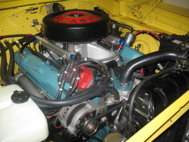

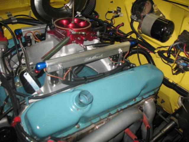

Performance wise I haven,t noticed any big improvements, maybe a touch more bottom end.Idles smoother,mpg increased on long trips ,example: last year to Moparfest in New Hamburg used 3/4 tank of gas on a 140 mile trip one way,this year just over 1/2-5/8. I like the ability to set the air/fuel to maintain performance and economy when needed. Need to do a 1/4 mile run to see if gains were made, the car ran great before the conversion.

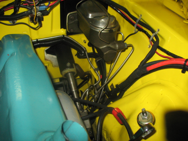

The efi harness runs along the drivers side valve cover, factory harness and msd on the passenger side.

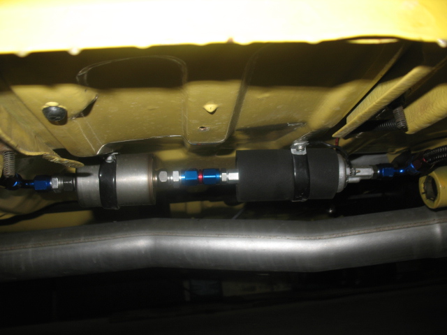

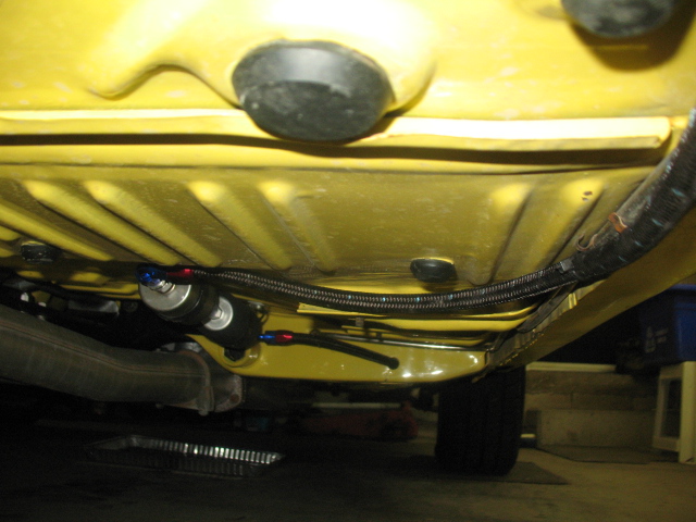

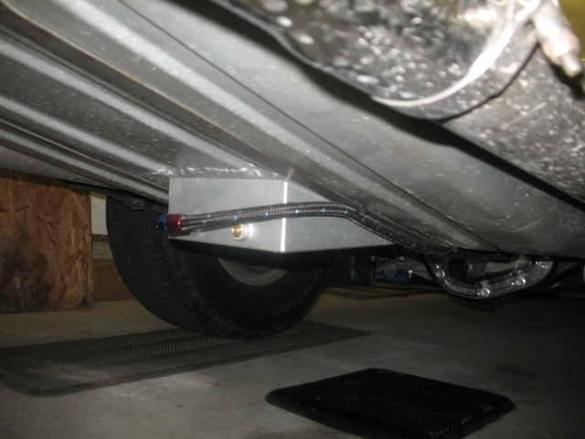

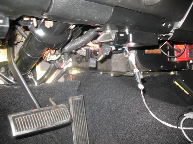

Installed the harness in my garage,assembled the manifold,rails injectors on my workbench, then to my mechanic buddies shop to do the fuel lines ,gas tank,intake etc. Estimate 8-12 hrs to do a clean install
This is a pretty good deal compared to alot of others.
Scott Brown was great to deal with,upgraded the injectors to 42 lb from 36 lb supplied in the kit,as well as the fuel pump for 600 hp and pump relay harness. Scott can also spec the cam as well,running a hydraulic flat tappet he sent me when I built the engine 6 years ago.Sound,s nasty still making 12"-14 " vacuum in a 496 11:1 stroker motor.
