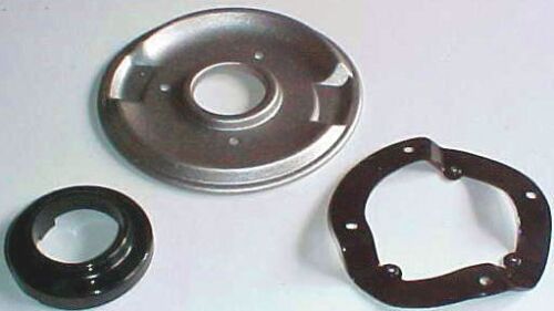

66 and 67 filler necks are the same, but without the proper seal they will leak. The GTX cap takes a special seal so as not to leak.
@Jerry Hall are factory ones different than the seal the reproduction's come with?
The reproduction seal for the GTX cap is good.

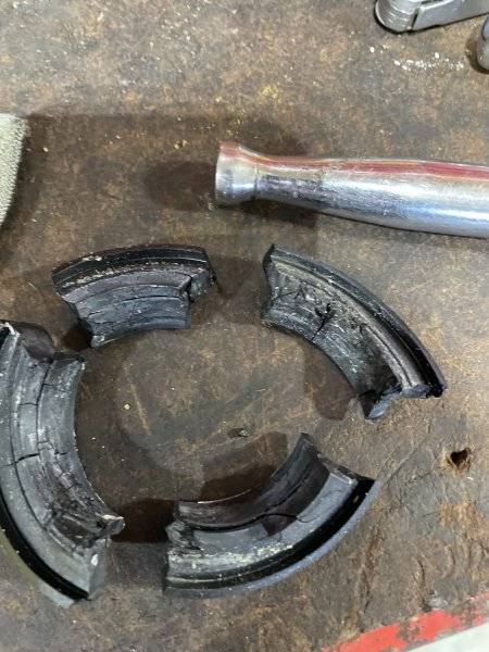

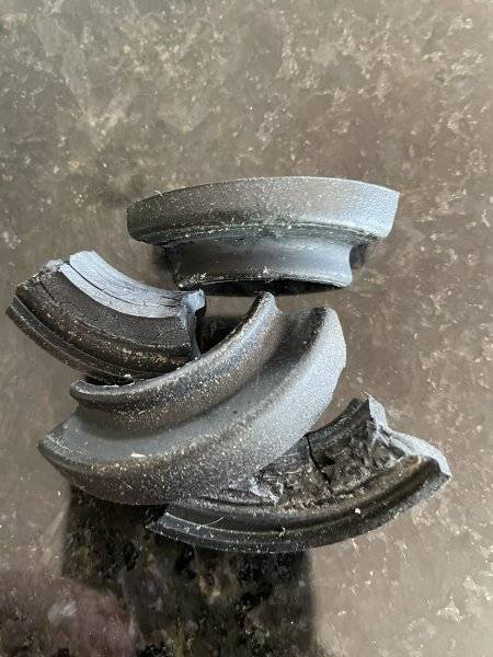

This is what’s left of the gasket behind the fuel door. Where can I get one?
