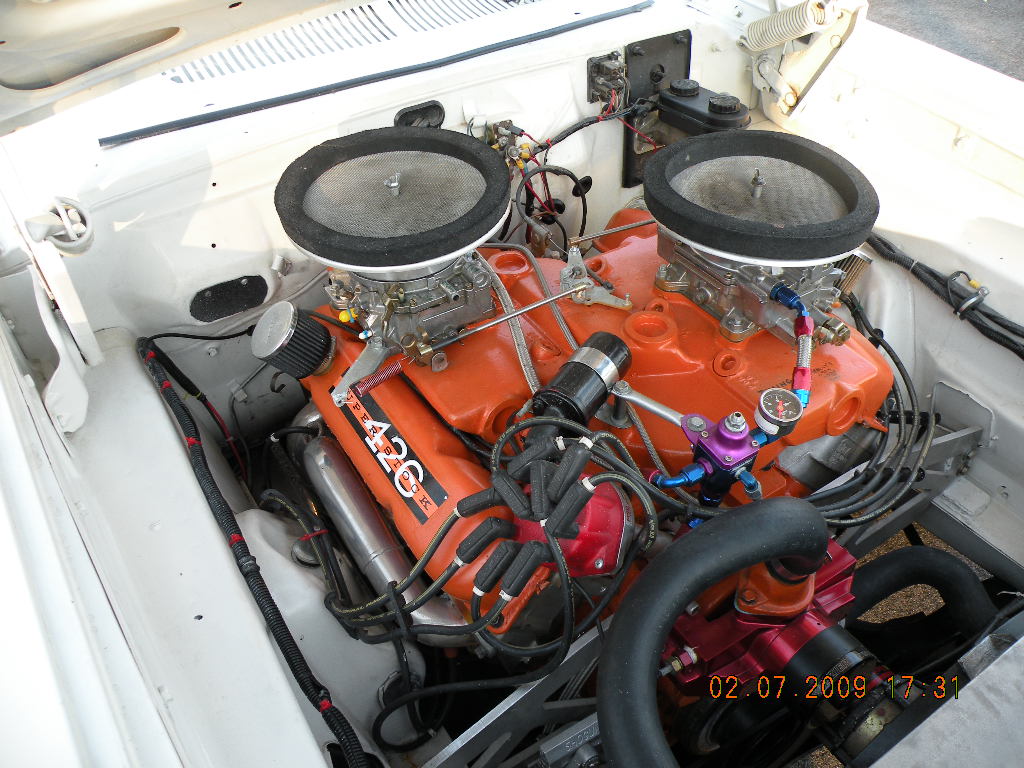

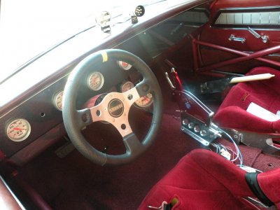

I installed a Mallory fuel pressure isolator on my car a couple weeks back. I run a dead ended regulator with two lines coming off to feed the carb. I had a tap and a small gauge on the rear bowel line at the regulator and had the pressure set at 7 psi. I left this gage intact to have one in the engine compartment and ran the isolator off a tap on the front bowel line from the regulator. Fuel to one side of the isolator and coolant on the other side into my interior gage. Thought I had the line full of coolant but the interior gage reads a bit over 9 psi while the gage in the compartment still shows 7 psi....:head_smack: Does this mean I still have air in that darn line ???:banghead:

Yea, these measurements were with it warmed up. The little gage is not liquid filled - just a cheap Holley from the parts store. I'll get another one at some point. I'm more interested in getting the interior gage reading correctly. Right not it reads 0.8 psi more than the test gage did. It is also not a liquid filled gage - Autometer mechanical.

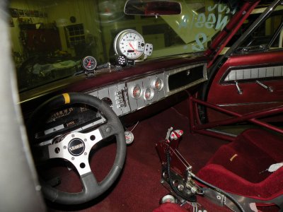

I run a electric one inside my dodge coronet

Yea, that would be an option. Never had an electric fuel pressure gage before. Do you set it against a standard mechanical or?
I have a mechanical gauge in my engine compartment.I like to set my regulator from that gauge and then read my interior one which is usually very close.

I have a mechanical just off the regulator also for making adjustments. This is the one that will need the new gage now .... I've been trying to get the interior mechanical working properly too but it seems to read about 0.8 psi higher than the test gage I used on the regulator. I guess maybe if that gage is also screwed up and I need to get anther for inside maybe I'll just go electrical and eliminate all this headache with the isolator.
