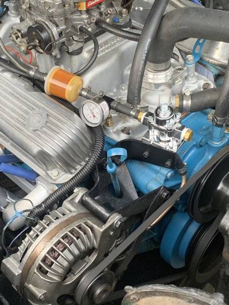

I for get the brand but I think it's Holley. I mounted it on my 360 small block in my 65 Belvedere wagon. Mechanical fuel pumps were too high and causing the carb to flood at idle. This took care of it. I just had to fabricate the little bracket on the alt bracket. It's the 65 alt set up but you get the idea. Now it's at 5-5.5 psi.
