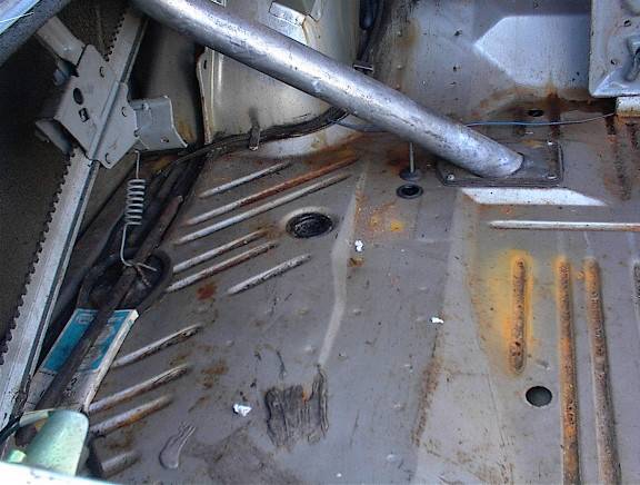

Hello, i am little confused on how to properly connect the gas tank vent line and 1/4 return line that goes to the separator? WHat i see now is the small port on the sending unit has the fuel cap vent line attached? Should that port be the 1/4 return line? If so where does the fuel cap vent line to to? I see many ports on the passenger side of the tank? THanks
The 1/4 inch at the sender is your return line. On the Charger your fill tube will have a 1/4 tube off it. That is your vent.
Thanks, where does that tube connect? It is currently connected to the fuel sender at 1/4 tube
Who ever connected it there should not work on cars. It just goes down through the trunk floor inside a grommet into the frame rail.

Yea right! It did not make sense to me why was the vent connect like that!
