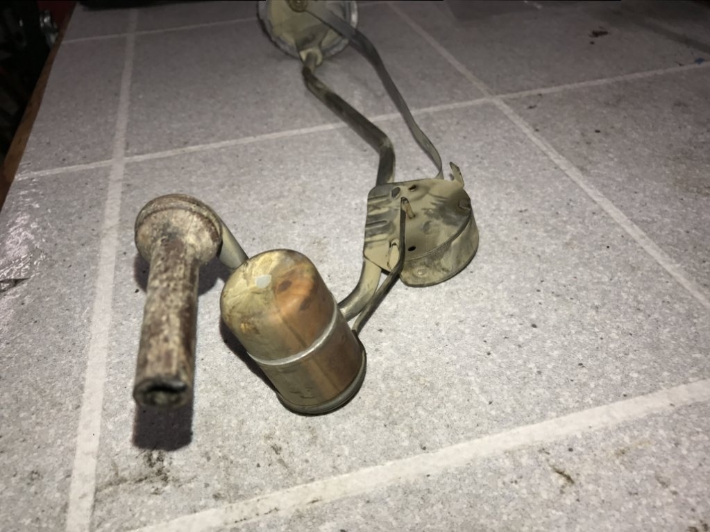

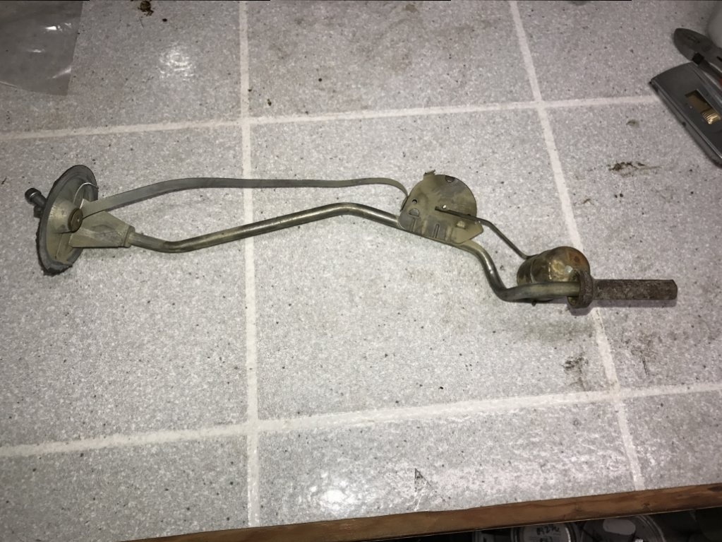

Here is my unit. I can't find markings on it so I'm not sure if it is stock.
Is there supposed to be liquid in the float? That might be my issue if the float won't float?
The end near float is ugly. Did it have a sock on the end or is that dirty thing the sock. Floats you can buy them. You can test it now that it's out. Judging by the look of that I'd pull the tank and have it cleaned.
383 sending unit.....As Fran said time to check the tank as well....
If it is a stock unit pm's and chrysler stamp will be on the outside face of the sending unit on the outer edge
The end looks like a hose not a sock. I have thought that the tank looked like it had sediment sitting at the bottom when I have looked in there. How would I go about cleaning it out? Just water or something else?
Also, the sediment might explain why I have two steel filters and one yellow filter on my fuel line up in the engine bay.
This is the most expensive tank on ebay. Made in Canada $169.The low cost is $104. The other guys will probably have cheaper idea's. Boil it out or use tank sealer to coat inside of tank.
With tank sealer the problem use to be peeling because of the new gas. Guys with more experience will have an answer.
