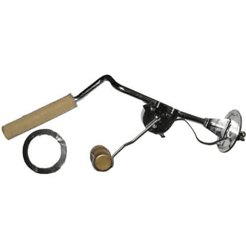

Anyone ever purchased the Golden Star sending units from JEGS? Curious if any good or what others have used.
In general, it seems the aftermarket sending units aren’t accurate
I have one from Vans in my charger and it works fine.
68-70 b-body folks are still out of luck for a decent unit unfortunately.
I do notice that one for yours (thanks for the link @BeepBeepRR ) is apparently made in Taiwan,
so maybe there's hope for that manufacturer?
I have the big 25 gallon plastic tank. Plastic is about 1/4 inch thick. Original unit went in the front side about have way down. It was shot. Got a sender from a marine store. It goes in from the top. Top to bottom of tank needed to match the sender. Cut a hole in the tank top, screwed the new sender in place, got a new gauge and it all works.
Later found a gauge that could have worked.
