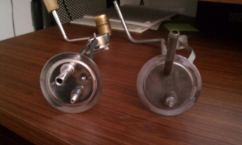

Is this what you are looking for? Original on the right, new one on the left. Its actually 5/16 inch and only difference between new and old is the curve on the outlet pipe. If this is what you need its part number BF657 from YearOne.
on 3/8 retun line where is it supose to go my old one had no return nipple and i need 3/8 not 5/16 idrivedoge but thanks for your help
Good luck with the 3/8, because 73/74 used 5/16. Older b-body and some A-body used 3/8, and the 73/74 has no return line from the fuel pickup as its all handled by the vapor seperator in front of your tank.
Ok, i found some additional information, if your car is a "U" coded vin, indicating 440 HP, then yes, 3/8, otherwise all other is 5/16. If so, maybe more rare, and hence the problem finding the correct size pickup.
