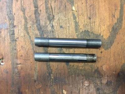

Maybe someone can measure one to establish what a normal one is ?

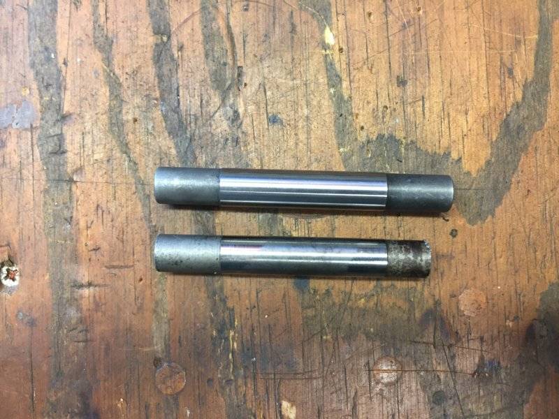

I will be doing before and after measurements. I’ll post them up. I am curious to see how worn out mine is. I also need to record it in case I need to troubleshoot later.
WOW! Now that is a scary sight! A worn pump rod like that would make me start wondering about lubrication.
No worries, the camshaft is good, so are all tappets.
Even de camshaft lobe for the pump rod is not damaged, last time i checked some marks were there but should survive.
If lubrication was that bad due to oil quality or so everything would have run to the ground already.
Most likely a cheap repo, i installed a NOS rod.

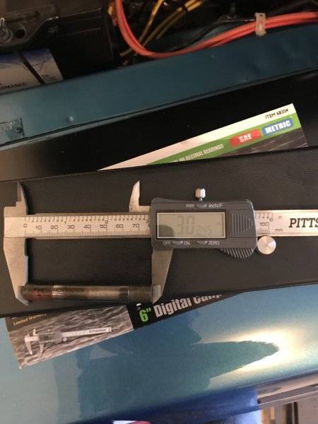

Looks like I found a culprit. The old one measures in at 3.024”. A little short. Story of my life. LOL
That is almost a quarter inch short.

Mine measured 2.967" when i removed it.

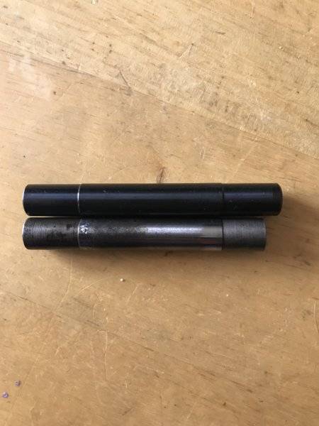

What new rod did you buy?
I got the Howard push rod recommended (Part number 92152) but best (they say) is NOS as they are properly hardened and survive longest.
I took a measurement prior to installing of the length, note it down and drive the car for 50-100 miles and check again.
If it has worn again a quite substantial amount there is either more damage, or the push rod is not hard enough.
Keep checking Ebay or so for a NOS push rod, good to have in stock :)
Edit: I've said this before, just replace it on a yearly basis if wear is found, can't go wrong for $20-25.

It was definitely the rod. Installed the new one. Ops check good. Big difference in lengths. Thanks for the advice!
