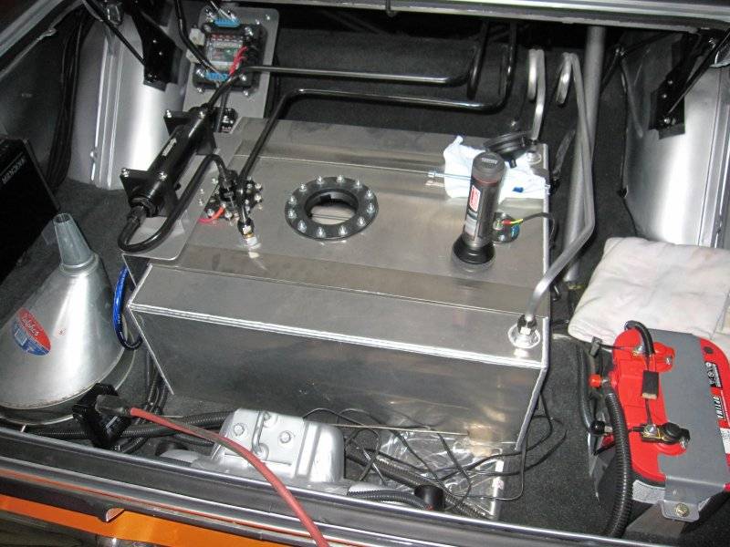

I am looking for a pair of shut off valves for my fuel cell vent lines. I'm using 1/2" aluminum tubing for the vent lines. If I could shut down the vents while in the shop it would sure smell better! No luck with my search so far. Any ideas fellas?

Are you super sure that the fuel vapor is emitting from the vents? The photo looks like the tank is missing a fuel pump. Check for all paths to atmosphere before thinking about blocking vents.
Old photo, before any fuel was added.

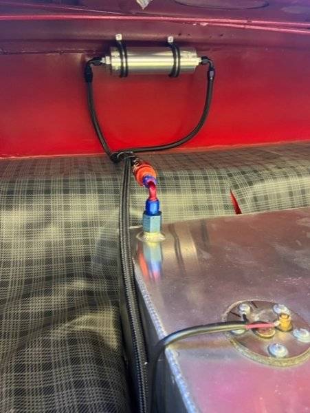

I started with a check valve from Pegasus Auto Racing. That helped some for the regular fuel evaporation. But, when the fuel in the tank expands, the check valve "burps" and the vapor smell was back. I installed a "Vapor Trapper" from Shop 48 and it virtually eliminated all gasoline smell. Well worth the investment, particularly with my garage attached to my house. The Vapor Trapper must be installed above the fuel tank so no liquid gets into it. The Check Valve helps with that during "Unplanned Sudden Acceleration"! I mounted mine above the tank and routed the vent line back thru the trunk floor to the atmosphere. Highly recommend this product.
