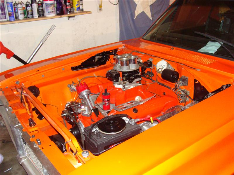

We dont have an air fuel section so i,ll post here. I need pics of throttle brackets for big dominators.I want th cut and polish my own out of aluminum plate. No kickdown,manual valve body. will the stock pedal cable have enough travel for a dominator? heres a pic of where i need to fab the bracket. Also does anyone know if a newer tank grommet for the fill tube will fit a 66 b body. If so i desperately need a part number like say for a 75 dart because the 66 number is discontinued. thanks

I can send you a picture of mine, but you can buy it off the shelf from Mancini. Its an adjustable 2 piece bracket. Or you can use a race style cablt bracket from A.R.T. inc.
