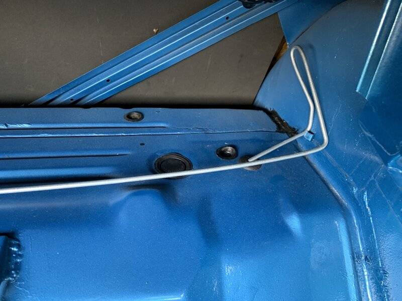

I smelled gas in my garage today
My coronet gas vent was allowing gas out and there was a puddle on the ground
I think I have it routed wrong....the gas was coming out a drain hole in the frame rail
I think i have 2 grommets mixed up
I think it should be in the other hole (see pic)
[ATTACH=full
Two tank vents and pending whom made the tank they get mixed up. Shine a light into the tank, via the filler neck, and determine which vent tube is the short one and which runs right up beside the filler neck. The vent up to the upper rear shock mount bulkhead connects to the LONG vent up to the neck and the short vent is the one that connects to the loop up into the trunk. And the looped trunk one IS supposed to go into the frame rail, with the thought it will evaporate from there before it hits the ground (which didn't happen for you!)
Research the defective reproduction fuel tank issues. You may have the mixed up nipples.

I am sure that a little pressure or suction would verify whether there is a problem. My car had the same issue!
