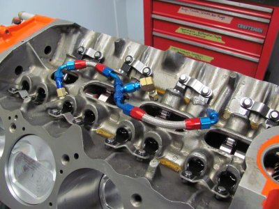

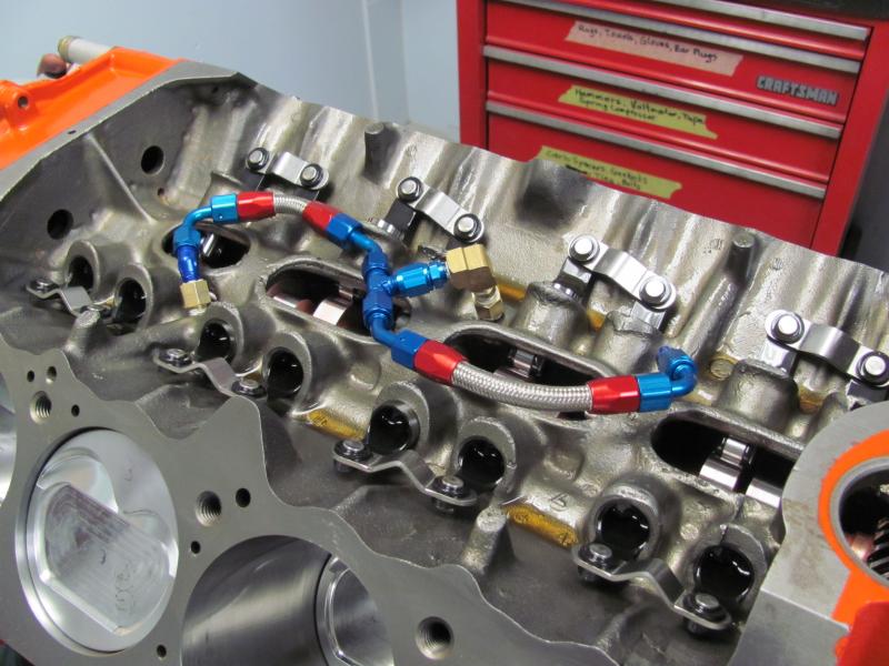

This is a 600HP pump gas small block but you can do the same thing to a big block. Rotate the cam bearing so that it oils the cam journal but blocks the oil through the block to the rockers. I think I ended up just redrilling a hole to feed the cam journal. Then you can run off the lifter oil galley to the passages up the block to the heads and rocker arms. The brass fitting screwed into the rocker arm oil passage is drilled and tapped for air bleed jets and I believe we finally settled on a .040-045 jet. The lifter galleys receive oil after the main's oil galley.
So...........I guess my answer would be that a .045" hole to each rocker shaft should provide enough oil.
