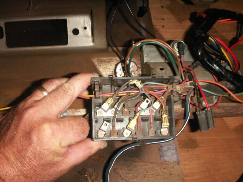

This is on my 64 Dodge. Can someone tell from looking at the back of this which connector to run a wire for the electric choke to. I know it should run to one controlled by the ignition switch...........correct?:edgy:
You do for sure want to run it to a fuse that is run by the ignition switch. There should be an accessories plug that will take a spade connector that is only hot with the switch on. I am looking at a 1965 fuse sheet. That is as far back as this book goes. The fuse box for all cars have this acc. plug. The fuse in it should be 3ag/agc;20 amp. Hope this helps somewhat.
