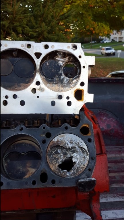

If you go with the stealth, I would recommend changing the valves as well. The valve broke off at the head.
That's ugly!
