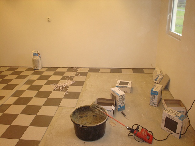

Why not granite tiles? I have a 500 square feet in my shop and it was not so expensive in Sweden and will probably be even cheaper in the US like everything else...
Payed around $800 for the tiles, grout and fix.
Just mix the fix so it floats under the tiles so you don´t get any air left under, then it holds for jacks and stands too.
