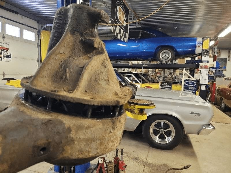

I used a sealer on mine and I have to say that I really screwed up by doing that. It looked great at first, all shiny over the burnished and light gray dyed concrete. The problem is that oil etc gets through the sealer and than you can't get the oil stain out. I should have used some sort of epoxy or nothing at all. The concrete floors at my company shop have had tons of oil , grease, fluids on them with no coating at all and would come up like new with a quick pressure wash every other year or so. Using only kitty litter kept them looking respectable between washings. If you're only parking and polishing it's one thing but if you're using jacks and stands, cutting torches, welding etc.makes the walls look good and try not to look down. There is a website called "The Garage Journal" that may have some good ideas on the subject.

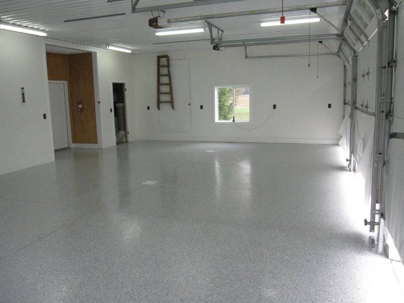

I will second the GJ site. I have epoxy in my parking area and we use the room for parties too. It easily cleans up. My shop floor is clear sealed concrete but, spilled gasoline will soften and raise hell with the sealer. Sparks from cutting torches and welding will/can mar any floor. Even with bare concrete. Now a sheet of plywood can stop a lot of spark damage.

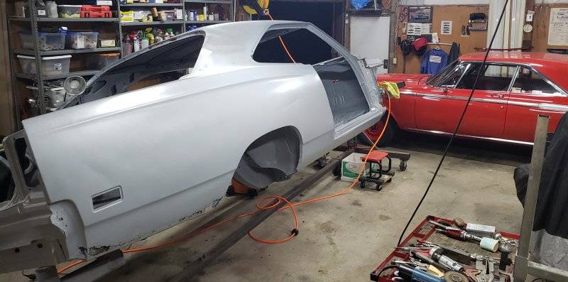

I agree with everyone asking what you are using it for. i just put an addition on my shop and had to make the same decision.
My current shop has the cheep Rustoleum epoxy system from Lowes. It held up reasonably well for 20 years but its not something I would choose again. I gave the concrete months to cure and did a deep scrub then an acid etch when I put that down. It lasted in my light traffic bay but in the bay that has had over 100 engines and transmissions pulled it has a big area with no epoxy left on the floor.
My new garage bay is going to be used hard. Mopar floor pan welding, rear ends, engines, trans, suspension parts, etc.
I looked at epoxy with a polyuria top coat which is an excellent option in a light to medium use environment. It would look beautiful but it just wont last in my situation.
Polishing and impregnating sealers look nice if you have a machine finished floor to begin with but they will dust and wear over time.
I ended up choosing Hellfire Coating for my application. It will not burn with grinding or weld splatter, gives an eggshell concrete color and is extremely resilient. It is also easier to apply and far less expensive then a multi-process epoxy system.

I used a two staged epoxy ( from Anchor Paint ) and it has held up well. The original coating went 20 years w/o looking sad or getting thin, and I was working out there a bit and trying to support a race car, so floor jacks and jack stands were a regular stressor. Wiped up easily and petrochemicals didnt seem to faze it. (I might add that the 're-do' isnt holding up as well and Im not out there much any more; just like everything else, it ain't near as good as it usta be...)
You're miles ahead starting with clean concrete. Even with that, clean the dickens out of it first - this is imperative from what I know of it. Start early of a morning as it will take longer than you think; brush it your edges and then start the open expanse. Be careful what material you use in the roller [if you use one - it does make it easier] so the roller doesnt come apart and leave chunks... don't ask me how I know. Let the finished product sit/dry for at least 3 days. The longer the better.
I've done the epoxy paint 3 times and recommend it; looks nice and makes clean ups very easy. Doesn't stain. Mine has never looked as nice as 493Mike's above, but still looks a lot better than oil stained concrete. I have no experience with some of the newer stuff personally, but some shows some real promise I think. An acquaintance just put down - actually had put down - some of the new 'polyspartic' I think its called stuff and it is gorgeous. Has a unique 'feel' to it also, but I would guess it won't hold up under a lot of use; of course, what do i know? It's supposed to be long-lived and tough. His garage is basically a 'showroom'. Will look into it further myself for 'the next time'.
Just be sure to use the 'Industrial/Commercial' stuff as opposed to the 'homeowner' grade which is designed to paint your back porch. I would recommend considering throwing in a bunch of those 'chips' - little flakes' - tho to give the surface some irregularity. If you live in an area of high humidity, the floor can get pretty slick sometimes and I think those will help.
