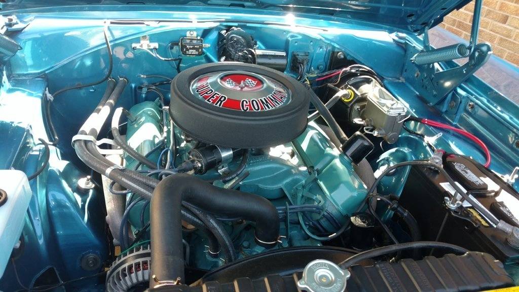

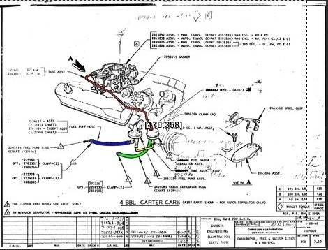

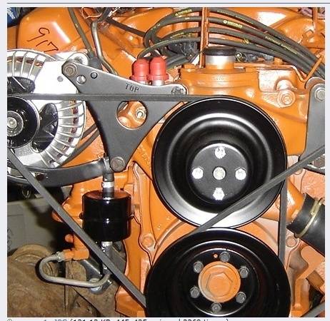

i don't know about the 69 but my 68 440 has a vapor separator located behind the alternator. I have four lines, fuel, return to vapor separator and two direct vent lines.
Thank you. I took a closer look and my set up is like this: looks like i have 4 lines...2 fuel - near the sending unit and 2 vapor- at the top of the tank. one fuel supply is routed to the Mallory pump, the other is clamped /plugged. One metal vapor runs up into the trunk does a loop and exits behind the spare. The second metal vapor line is the J shape and just stops about 5ish inchesfrom where it begins.
So with all this...is my leaky gurglemonster fixed if i use a vented gas cap? Existing cap is not vented
On the 68 the second line near the sending unit returns to the vapor separator. The fuel pump connects to the separator and then the top line from the separator connects to the carb.
