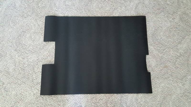

This is what I bought for my '62 Dodge. Got it through Classic Industries. Thick soft rubber. Just got the first couple of threads started on the strap bolt by hand. Cranked it up the rest of the way with a wrench. It's not going to squeak!
