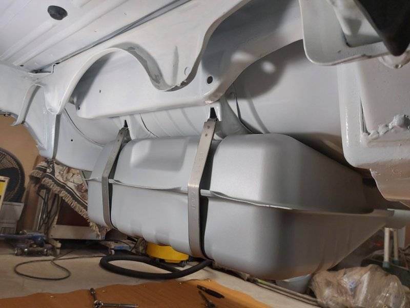

These new gas tanks are battleship gray. They look terrible. Is there anybody that sells a tank that is silver that's looks more original? Like they sold a few years ago in the aftermarket.
Mine in 2017, Spectra. Made in Kanukastsan !

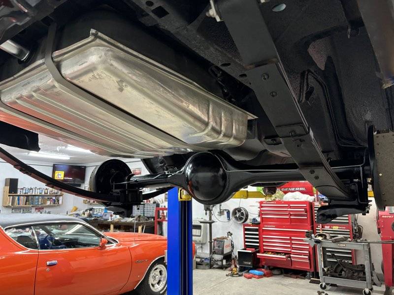

My Spectra i bought a year ago is silver, and not gray at all... also fit perfect and the sending unit works and no leaks.. Best pic i got...
