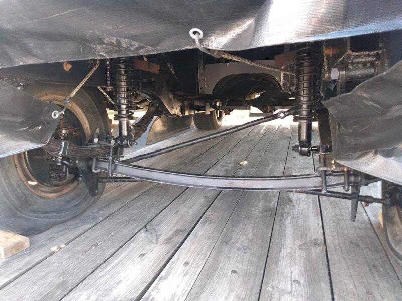

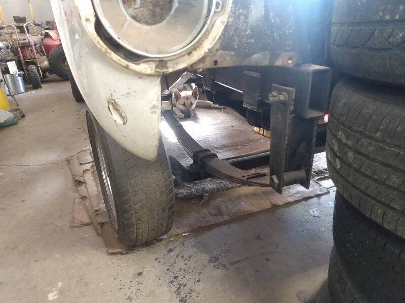

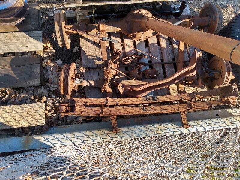

Can make just about anything work. Width and steering set-up makes things a lot easier if they match your project. Some not so good quick pics. First one a '69 Dodge van axle narrowed to fit a-body (done 30+ years ago). Second is a mail truck axle, I believe) on a '55 Chevy ( done 50+ years ago). Last is a '46 Chevy that my neighbor has, that I may help him put in a '55. I, personally, do not like tube axles for retro Gassers. Not to mention disc brakes !!! Might as well put air bags and lane departure warnings on them.

Can make just about anything work. Width and steering set-up makes things a lot easier if they match your project. Some not so good quick pics. First one a '69 Dodge van axle narrowed to fit a-body (done 30+ years ago). Second is a mail truck axle, I believe) on a '55 Chevy ( done 50+ years ago). Last is a '46 Chevy that my neighbor has, that I may help him put in a '55. I, personally, do not like tube axles for retro Gassers. Not to mention disc brakes !!! Might as well put air bags and lane departure warnings on them.View attachment 1024653 View attachment 1024654 View attachment 1024655
I agree. Tube axles are weaker than an "I" beam and tend to twist during heavy braking and anytime it is subject to major movement. They're great for a light weight street rod but not for something heavy that's driven on the street. Just my opinion though... I'm sure some will disagree.
